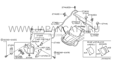

Water tank is located behind right protective wheelarch liner. If you want replace it by you self you should take off front-right wheel then protective wheelarch liner. You better reach out to a garage.
PA33 S-Touring, 1999 г., VQ25DD, у299АР
Hello !
Ok, I will write in english, it might be better. I think, that this should be the solution for my problem. Has anyone made such a repair before? Where are screws located? Must I remove the bumper or not?
It would be perfect, if you have a picture how to fix it.
So many thanks!
best regards,
Tim
Tim, I have only this picture.
I don't think that it's relevant will you demount the bumper or not. In any case you need "warm" covered parking for processing and spanners (on 10-12).
You better begin with demounting of right protective wheel-arch liner and try replace the tank without demounting of the bumper as I sad above.
Why don't you want to send the car to be mended? Our car mechanics can repair a water tank with a mastic, glue or burning.
Tell us where are you from (city) and we recommend a good garage.
    98.4 КБ · Просмотры: 1 817
